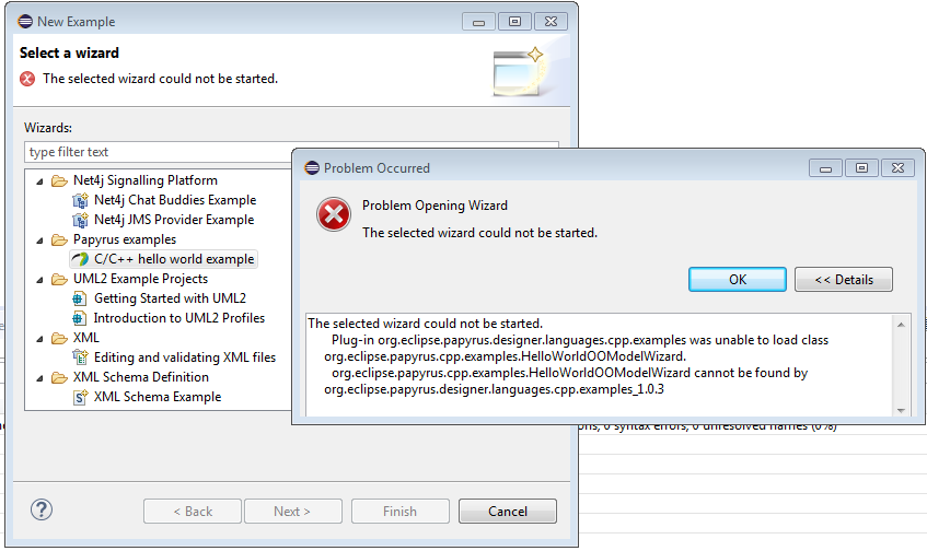

I tried to created the Papyrus C/C++ hello world example and it failed.
File->New->Example...
Select Papyrus Examples->C/C++ hello world example
index.php/fa/28788/0/
Am I missing something?
Steve

there has been a problem with the path to the class loading the example. This has been corrected and the examples have been restructured. The example you are looking is in the category "Papyrus designer examples based on direct code generation"
We will make a new release soon, in the mean-time you can use the nightly update-site:
https://hudson.eclipse.org/papyrus/view/Designer/job/papyrus-designer-neon-papyrusnightly/ws/releng/org.eclipse.papyrus.designer.p2/target/repository/
