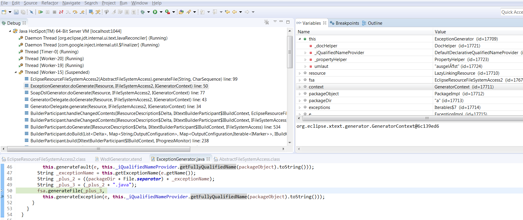

Just followed your proposal: Find attached a screenshot showing the debugging of a generator that has special characters set. As you can see, the generator java class (derived from xtend implementation of the generator) has the special character set correct. But after these string get appended to the StringConcatenation, the encoding seems to get strange.

The variable value is also in a strange encoding. See ..DuringDebug Screenshot.
