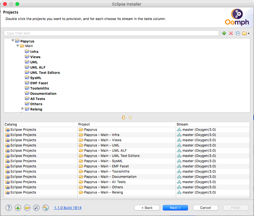

The picture below shows how I config the environment.
index.php/fa/28326/0/

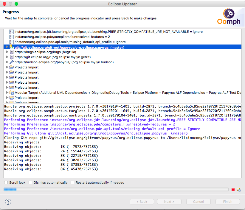

When it comes to the step shown below, there are errors shown in file 'errorEclipse.txt'.
index.php/fa/28328/0/

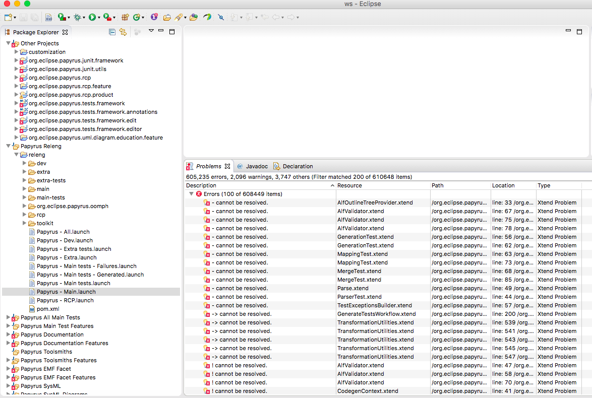

Then I click the back button and finish button again, it can successfully setup the environment but there many errors as shown below
index.php/fa/28330/0/
From this file I see
java.net.UnknownHostException: hudson.eclipse.org
I suppose server was unfortunately down when you tried to fetch packages
