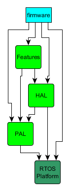

I'm attempting to utilize the "Project References" feature in Eclipse for an embedded firmware project. I'm using Code Composer Studio 7.0 which is essentially just a wrapper for Eclipse 4.6 with CDT 9.0 and JRE 8. However, from what I can tell the features I'm trying to use are specific to the CDT. The embedded firmware is broken up into several parts with a few libraries, an RTOS platform, and the "core" firmware.
The intention is that the dependencies of a project are automatically built and updated in the proper order whenever a build on the core firmware project is triggered. However, due to some libraries building upon others I'm seeing some weird behavior that i don't quite understand. The dependency graph is attached.
As you can see, there's a maximum of four levels of dependency. The issue that I'm seeing is that, while I've ordered the references in the order "Properties->C/C++ General->Paths and Symbols->References" as [Platform, PAL, HAL, Features] for the firmware project, the build order doesn't seem to follow that specification. The ordering seems to be semi-random. After a clean sometimes the PAL will build first, other times the Features will. The entire build ultimately fails when this happens due to dependencies not being accessible. Is there an additional step I'm missing to get dependencies to build in the correct order, or are nested dependencies not supported by Eclipse for some reason?

Although this property page (Properties->C/C++ General->Paths and Symbols->References) has "Move Up" and "Move Down" buttons to modify the order of the projects in the list, CDT builder completely ignores it. I think it is misleading if it was designed for visual representation or simply a bug. I haven't debug the code to check, which of the two is the case. My suggestion is to open a bug report: either remove those buttons to avoid confusion or ensure that the order in the list applies the build order. Please post the bug number if you do.
My CDT 9.0.1 has the same problem with three small projects.
There is another similar properties page, "Properties -> Project References". Note that this page has no option to define items order. This page is from base Eclipse, not CDT.
To resolve your problem, try to define the inter-dependencies as in the graph, e.g. HAL->PAL, PAL->RTOS, Features->HAL.
