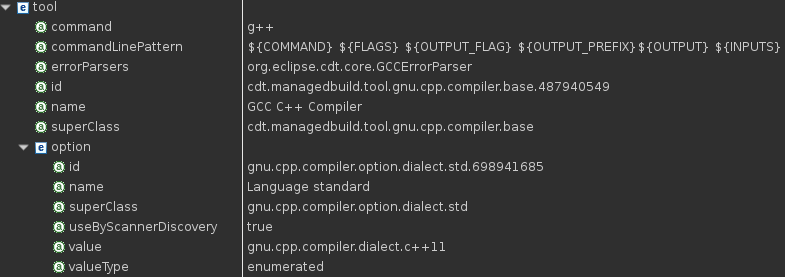

Re: Losing C++11 settings in Neon.2 [message #1753356 is a reply to message #1753328] Sat, 04 February 2017 09:01 Go to previous messageGo to next message
The c++11 option is kept in the .cproject file. Appears this is being overwritten.
Here is the relavant part of the xml for .cproject in my HelloWorld project.
Note the dialect value near the bottom.
index.php/fa/28341/0/
[Updated on: Sat, 04 February 2017 09:06] by Moderator

Re: Losing C++11 settings in Neon.2 [message #1753364 is a reply to message #1753361] Sat, 04 February 2017 14:50 Go to previous messageGo to next message
Sorry. I misread your problem. The setting in .cproject is for the makefile creation.

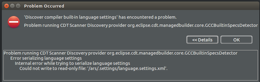

Re: Losing C++11 settings in Neon.2 [message #1753472 is a reply to message #1753468] Mon, 06 February 2017 16:06 Go to previous messageGo to next message
I am using
g++ 5.4.0 on Ubuntu 16.04 and eclipse 4.6.2(neon.2).
I've tried it many times now and every single time I build the project from within eclipse, the language.settings.xml file gets updated.
I have also noticed that the file also gets updated back to default settings any time the project gets opened, either via closing and re-opening the project from the project explorer or by closing and re-opening eclipse itself.
Just for fun I set the file as read only and this is the error I got when re-opening the project.
index.php/fa/28360/0/
I'm not sure if I have any type of weird settings. I've always built outside of eclipse so I've never intentionally changed any build settings.
I will try setting up a new workspace and new project and see if I can duplicate this behavior.
