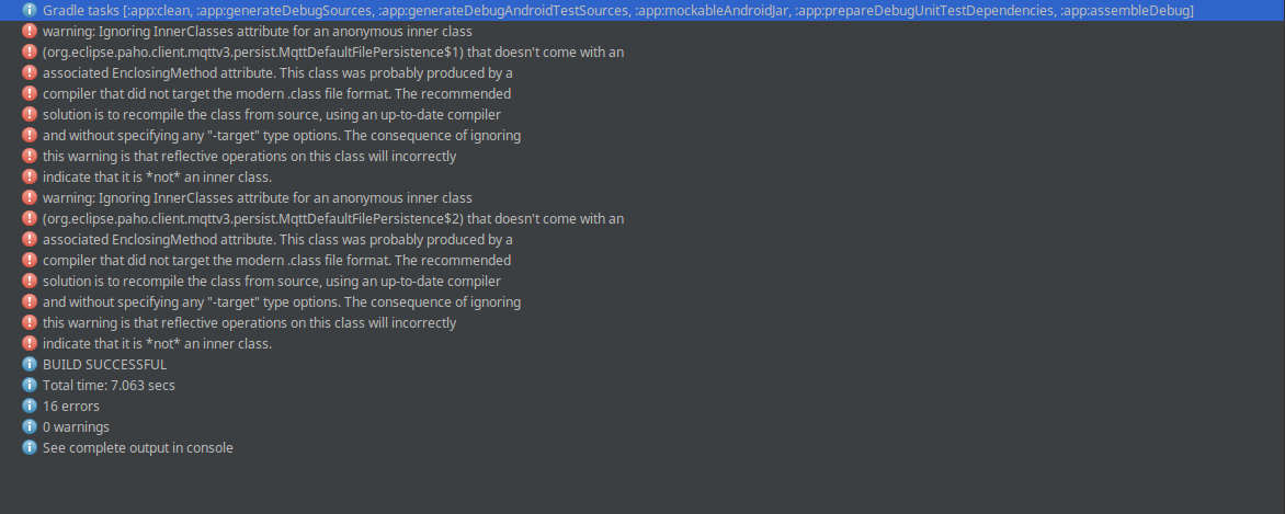

I used the following repositories to use Paid in Android Studio:
repositories {
maven {
url "https://repo.eclipse.org/content/repositories/paho-releases/"
dependencies {
compile('org.eclipse.paho:org.eclipse.paho.android.service:1.0.2') {
exclude module: 'support-v4'
The sample code I used
String content = "Message from MqttPublishSample";
int qos = 2;
String broker = "tcp://iot.eclipse.org:1883";
String clientId = "JavaSample";
MemoryPersistence persistence = new MemoryPersistence();
try {
MqttClient sampleClient = new MqttClient(broker, clientId, persistence);
MqttConnectOptions connOpts = new MqttConnectOptions();
connOpts.setCleanSession(true);
System.out.println("Connecting to broker: " + broker);
sampleClient.connect(connOpts);
System.out.println("Connected");
System.out.println("Publishing message: " + content);
MqttMessage message = new MqttMessage(content.getBytes());
message.setQos(qos);
sampleClient.publish(topic, message);
System.out.println("Message published");
sampleClient.disconnect();
System.out.println("Disconnected");
System.exit(0);
} catch (MqttException me) {
me.printStackTrace();
I do not know why I get errors when compiling?. HELP MY

Interesting, this post is from November and no answer.
I also have those issue. But I think, when Build is successfully then this is no problem.
