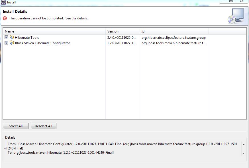

HI, I would like to install hibernate tools from http:// download.jboss.org /jbosstools/updates/stable/helios, however I cant because I have following problem:
Cannot complete the install because of a conflicting dependency.
Software being installed: JBoss Maven Hibernate Configurator 1.2.0.v20111027-1501-H240-Final (org.jboss.tools.maven.hibernate.feature.feature.group 1.2.0.v20111027-1501-H240-Final)
Software currently installed: m2e-wtp - Maven Integration for WTP 1.3.1.20160831-1005 (org.eclipse.m2e.wtp.feature.feature.group 1.3.1.20160831-1005)
Only one of the following can be installed at once:
Maven Integration for Eclipse WTP 0.13.0.20110623-0455 (org.maven.ide.eclipse.wtp 0.13.0.20110623-0455)
This version of m2e-wtp cannot be installed on top of the already installed m2eclipse-wtp. Uninstall the previous version of m2eclipse-wtp and try the install again. 1.3.1.20160831-1005 (org.maven.ide.eclipse.wtp 1.3.1.20160831-1005)
Maven Integration for Eclipse WTP 0.13.1.20110728-1800 (org.maven.ide.eclipse.wtp 0.13.1.20110728-1800)
Maven Integration for Eclipse WTP 0.13.1.20110718-1012 (org.maven.ide.eclipse.wtp 0.13.1.20110718-1012)
Cannot satisfy dependency:
From: m2e-wtp - Maven Integration for WTP 1.3.1.20160831-1005 (org.eclipse.m2e.wtp.feature.feature.group 1.3.1.20160831-1005)
To: bundle org.maven.ide.eclipse.wtp [1.3.1.20160831-1005]
From: JBoss Maven Core 1.2.0.v20111027-1501-H240-Final (org.jboss.tools.maven.core 1.2.0.v20111027-1501-H240-Final)
To: bundle org.maven.ide.eclipse.wtp [0.13.0,0.15.0)
From: JBoss Maven Hibernate Configurator 1.2.0.v20111027-1501-H240-Final (org.jboss.tools.maven.hibernate 1.2.0.v20111027-1501-H240-Final)
To: bundle org.jboss.tools.maven.core 0.0.0
From: JBoss Maven Hibernate Configurator 1.2.0.v20111027-1501-H240-Final (org.jboss.tools.maven.hibernate.feature.feature.group 1.2.0.v20111027-1501-H240-Final)
To: org.jboss.tools.maven.hibernate [1.2.0.v20111027-1501-H240-Final]
index.php/fa/27523/0/
I use Eclipse Neon. Please help me because I was trying to remove Eclipse and install it again and nothing can celp me.
  • Attachment: hiberror.JPG
    (Size: 59.12KB, Downloaded 526 times)

Installing software intended for Eclipse Helios (2010) into Eclipse Neon (2016) doesn't sound like a healthy exercise.
Please either find a newer version from jboss or find their forum to ask your question.
