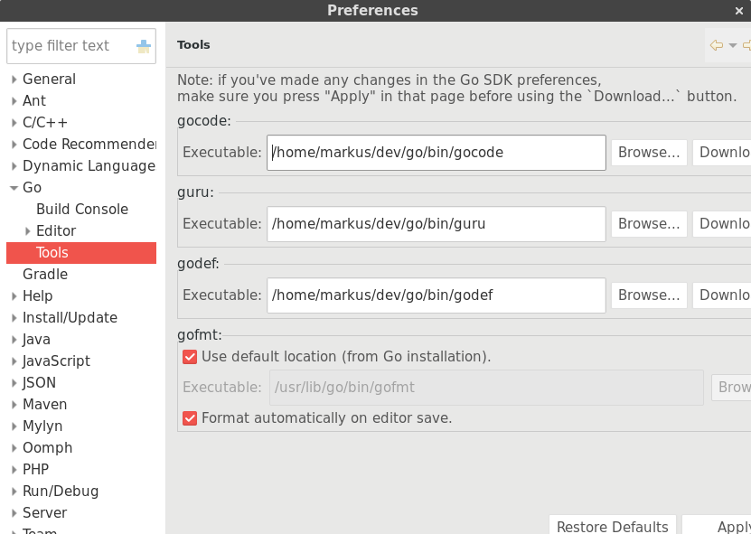

After upgrading from 3.20 to 3.22 today the Preferences UI had buttons partially outside of the window and in some places certain elements were not visible at all.
I now downgraded back to 3.2 and everything seems to be back to normal.
When starting from the command line i had gotten lots of gtk.css warnings.
I am using Gnome on Arch Linux.
Has anyone else had problems with GTK 3.22 breaking the UI?
Attached are a screenshot of the Preferences window as well as the console output after starting eclipse (Now there are only two GTK-wanings after downgrading)

Yes I am running Neon.1 (eclipse-java-4.6.1-1), the problem also occurred with the previous version tho (eclipse-java-4.6.0-1).
Could this also be a GTK issue instead?
It seems to me that a minor upgrade shouldn't break existing code this bad.
I have also tinkered with the GTK config before on this system, if I am the only one having problems it could be that the upgrade in combination with my config changes broke something.
If nobody else can reproduce the problem I will first take a closer look at my environment before filing a bug.
Edit: the exact GTK version is 3.22.1+8+ge11df6c-2 and it's only 2 days old so far https://git.archlinux.org/svntogit/packages.git/log/trunk?h=packages/gtk3
Edit2: The newest working GTK version for me is gtk3-3.20.9-1, earlier versions of 3.22 have the same issues
