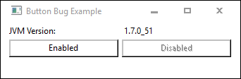

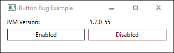

Not sure what is going on here exactly. Their seems to be a change between how SWT Buttons are displayed on 'Windows 10' with the 'High Contrast White Theme' when moving between Java 7u51 and 7u55.
With 7u51 buttons have a 3d appearance and disabled buttons appears as greyed out. With 7u55 the buttons have a flatter appearance and disabled buttons just are outlined in red.
Here is a couple screenshots showing the issue. The show a window which displays the JVM version and 2 buttons one enabled and one disabled. There is a screenshot for when the app was run against 7u51 and 7u55 with everything else being kept the same.

Any idea what could be causing this? Is there anyway to work round it (i.e force SWT to use the 3d greyed out version)?
This is using the Oracle Java releases via http://www.oracle.com/technetwork/java/javase/downloads/java-archive-downloads-javase7-521261.html
