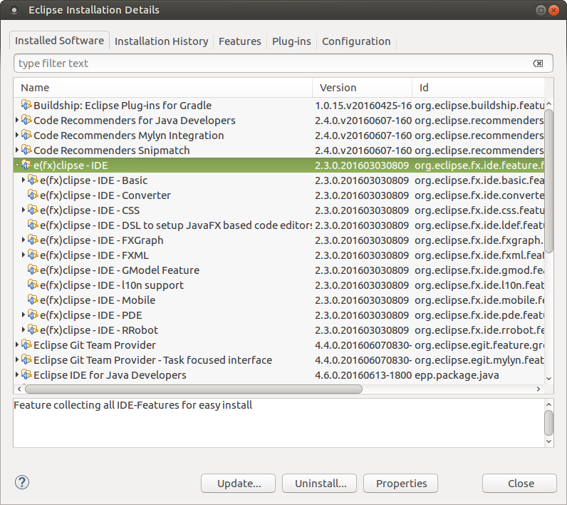

just to be sure that I have e(fx)clipse installed:
https://www.eclipse.org/forums/index.php/fa/26714/0/
