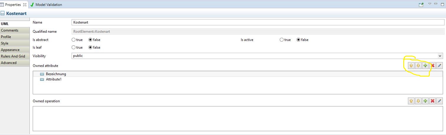

When I create a class diagramm the attributes of an object appear in the order of attribut creation. How can I change the order ? In the property pane are some buttons to change the order, but this has no influence on the attribute order presented in the graph. What are those buttons for then?
picture of the buttons: http://

Well, if there are buttons as shown in the screenshot and those buttons are to "move selected items up" and those iteams are attributes and after moving them up there is no change in the graphical representation, then I would call this a bug... as long no one in the community has an explanation for what the buttons are good for otherwise.

I think you mix up tree representation of the model with a shape on a diagram. The buttons you mention are related to the order within tree representation of the model. These buttons change to order within the tree representation of the model and that works as intended.
The order within a shape within a diagram that illustrate an element of the model is a completely different story. Papyrus allows you to use different graphical representations of the very same element of the model in different diagrams. As an example you might omit the attribute compartment of a class shape in one diagram while presenting it in another.
It is the same story with the order of attributes within a class shape. The order may (the UML specification does not disallow it) be different on two shapes representing the very same class of the model on to different diagrams.
