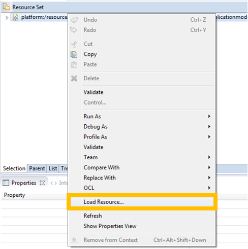

I am having two ecore metamodels A.ecore and B.ecore where the A metamodel reference the B one.
In my sirius modeling tool, i want to offer the possibility to load Resources (file.B) without passing by the A Model Editor (file.A), meaning, i want to create some kind of a button to imitate the same work that: right click on A model editor >> Load Resource ... does (Please find attached a screen capture).
So i thought of creating a Java service which invoke the EMF LoadResourceAction.

It should be possible with a Java service which:
- Asks the user which resource to load (how to do this depends on your
context, but you can open a dialog box if needed).
- Once you have the URI of the EMF resource to load, invoke the
org.eclipse.sirius.business.api.session.Session.addSemanticResource(URI,
IProgressMonitor) method which will load it and register it inside the
session.
> - does the Session should be retrieved from the Modeling Project where i have my model A ?
If you have access to a semantic element from inside your session (e.g.
the target element on which your tool was invoked), you can obtain the
session using:
new
org.eclipse.sirius.business.api.query.EObjectQuery(mySemanticElement).getSession().

Thank you so much for your answer. The dialog box that i am going to use is the EMF LoadResourceAction.LoadResourceDialog but ididn't know what to do with the URI once submitted.
I will try what you have suggested. Thanks again.
