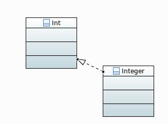

The following scenario is modeled:
Integer is a class
Int is a class
Int is realized with with Integer.
See image: index.php/fa/25976/0/
The following sample code can go over every class, iterate over it's dependencies, and print the dependency (supplier.name).
I would like to be able to resolve the supplier (or if it is the dependency for which I need to refer to) to it's class, to be able to check for a stereotype.

I have updated the code to better focus on my issue:
[template public generateByType(aClass : Class)]
  [for (aDependency: Dependency | aClass.clientDependency) ]
    [aDependency.supplier.name]
    [if SOMETHING.oclIsKindOf(Class) ]
      It is a Class type
    [/if]
  [/for]
[/template]
[template public generateElement(aPackage : Package)]
[comment @main /]
  [for (aClass : Class | aPackage.packagedElement->filter(Class))]
    [aClass.generateByType() /]
  [/for]
[/template]
Please notice: [if SOMETHING.oclIsKindOf(Class) ]
I need to find a SOMETHING derived from aDependency.supplier which is 'Int' as aDependency.supplier.name is actually printing 'Int'.
But aDependency.supplier is not of type Class... and I need to cast it to Class.
[Updated on: Thu, 26 May 2016 17:07]
