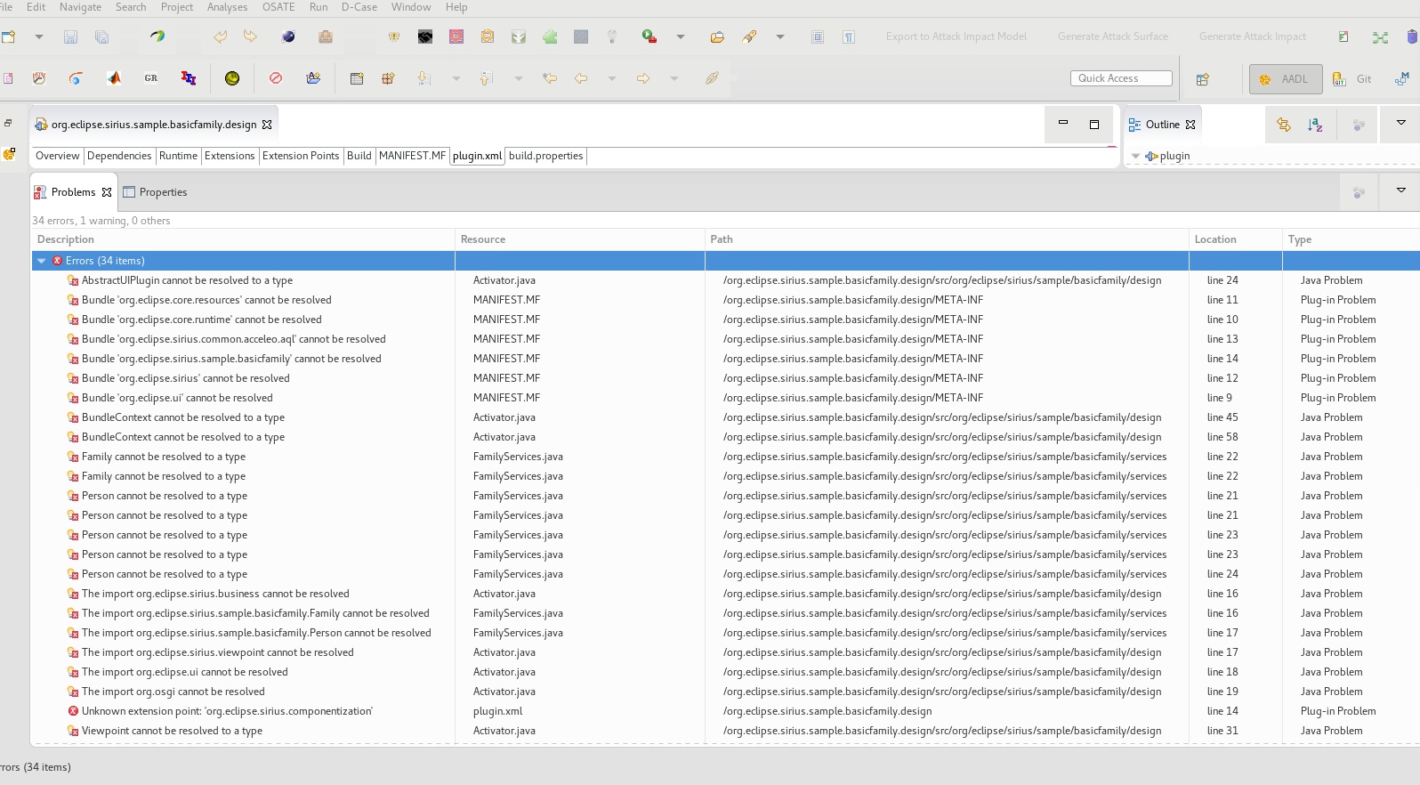

When trying to import the example project, I got the following issue (see picture) and the project cannot be started. Any idea why this happens and how to fix that?

Could you send us your configuration environment? (Help/About
Eclipse/Installation Details/tab Configuration.
Have you Sirius installed in your environement?
I see you retrieve org.eclipse.sirius.samples.basicfamily.design but
have you retrieve org.eclipse.sirious.samples.basicfamily metamodel?
Thanks.
