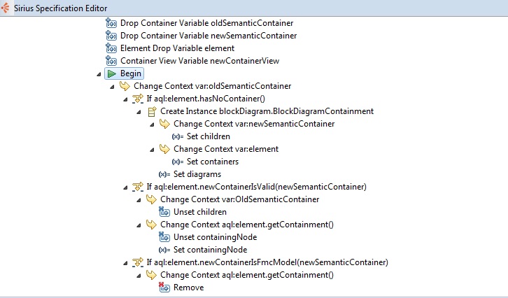

In my case, by dropping a container like the p1ToDropTop2 container to the diagram, I have to delete the containment between p1 and p1ToDropTop2. The containment is a model element. In addition I described that the Exception occurs when I drop from a container to another, but this works. The only problems are, when I drop the container to the diagram because then I have to remove an Element. And when I would drag the p1 Container with its subcontainers to p2.
So the problems are: 'create a new Instance' or 'remove an instance' whe the selected Container has Sub-Containers
In your case, there is no model element like a Containment element. Unfortunately I have to keep this mechanism
I attached the part from my odesign file here:
index.php/fa/25738/0/
