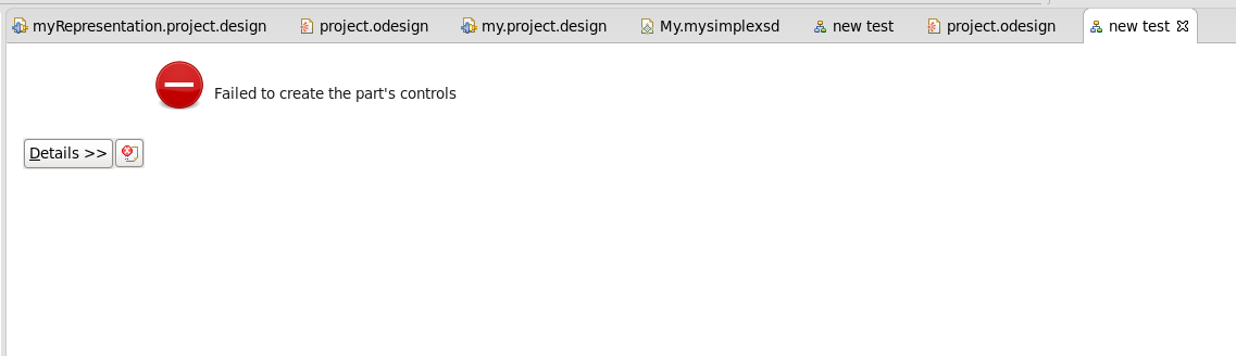

The problem is that Sirius is unable to reload a saved diagram once eclipse has been closed.

12 - This is what you get at this point : index.php/fa/25488/0/

  • Attachment: Capture-1.png
    (Size: 15.71KB, Downloaded 478 times)

I tried to generate the model/edit/editor code with the genmodel from the family example and it appears that I don't have any saving bug. We can conclude that the problem does not come from my eclipse configuration
So I guess that it comes from my genmodel (itself generated from an xsd constraint file), but I still can't figure out why it is not generating correcly my code.
Re: Bug with diagram saving (and opening) [message #1728531 is a reply to message #1728273] Tue, 05 April 2016 04:50 Go to previous messageGo to next message
Ok I am almost 100% sure it is a Siruis generation bug because when I generate my model/edit/editor with the EEF plugin I don't have this bug anymore. I tried to do a file comparison but coulnd't find any relevent differences. Strange...
Re: Bug with diagram saving (and opening) [message #1734123 is a reply to message #1728531] Sat, 04 June 2016 05:49 Go to previous messageGo to next message
I had the same problem. I was working on Eclipse Mars (4.5.1). After many frustrating trials, downloading Obeo Designer and using it as a design environment solved my problem. Hope this information helps other users of Sirius.
Re: Bug with diagram saving (and opening) [message #1734209 is a reply to message #1728182] Mon, 06 June 2016 04:30 Go to previous messageGo to next message
Even i am facing the same issue.So any one have the solution to the above problem
Re: Bug with diagram saving (and opening) [message #1736036 is a reply to message #1728182] Fri, 24 June 2016 10:06 Go to previous messageGo to next message
I am facing the same problem. I switched from Mars.2 to Neon using Sirius 4.0.0 but the issue did not disappear. After this happens, the model Explorer does not show the details of my model any more. The file node in the model Explorer has no children. Maybe this will help someone to solve the issue?
Re: Bug with diagram saving (and opening) [message #1736038 is a reply to message #1736036] Fri, 24 June 2016 10:25 Go to previous messageGo to next message
Have you checked the error log and tried validating.
I found that any deficiency in the model locked out the Model Explorer,
and it needed a good restart after fixing the model before children
reappear.
Ed Willink
Re: Bug with diagram saving (and opening) [message #1736075 is a reply to message #1736038] Fri, 24 June 2016 18:23 Go to previous messageGo to next message
I also had this issue. After a little digging i was able to solve it for me. Turned out I was using sub-EPackages in my ecore model and you should never do that. Since I extracted them to separate ecore files, everything works fine.
Re: Bug with diagram saving (and opening) [message #1736135 is a reply to message #1736075] Mon, 27 June 2016 00:22 Go to previous messageGo to next message
in my model also i have sub-E Packages but there is a relation between each sub-E Packages .If i extract them to separate ecore files, whether the relation still exists or not. How can we extract them to separate ecore files.
[Updated on: Mon, 27 June 2016 00:56] by Moderator
Re: Bug with diagram saving (and opening) [message #1736245 is a reply to message #1736135] Mon, 27 June 2016 15:51 Go to previous message
By "Load Resource" on a ecore file you can "import" a separate ecore file and make the contents known. You also can add multiple ecore files to your .genmodel
It is a annoying to extract all sub-packages but this should resolve the error. (atleast it worked for me)
