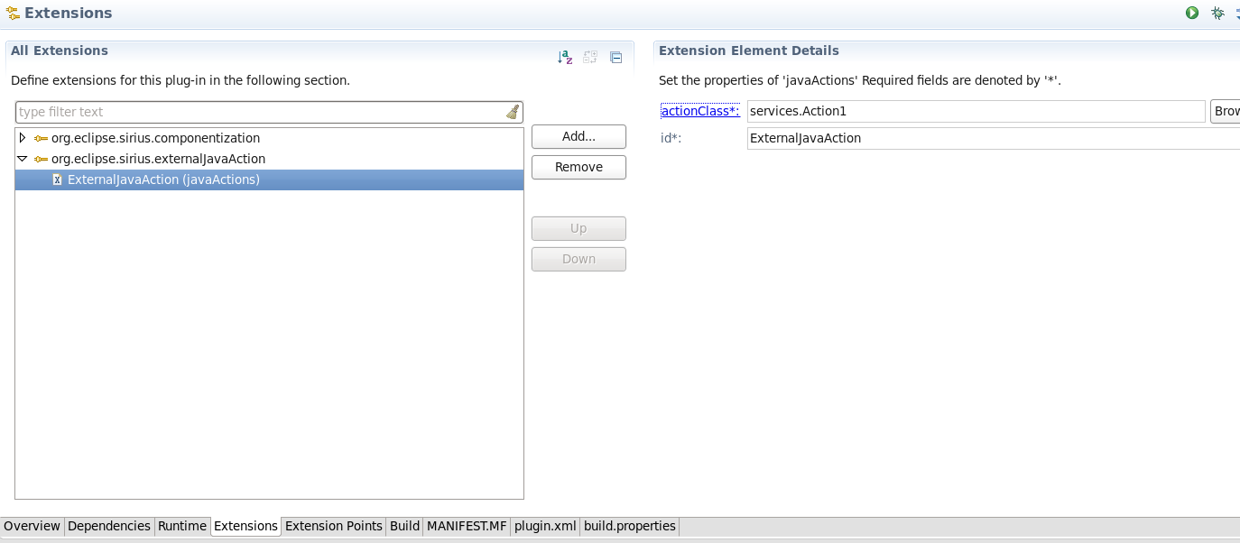

I have a problem that is blocking me since a few hours, I can't manage to call an External Java Action :
Here is what I did :
Add an Extension of org.eclipse.sirius.ExternalJavaAction.

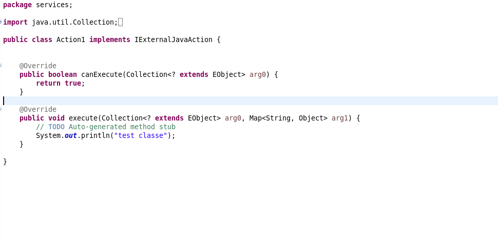

When I click on the class link it brings me to the class without any problem :
index.php/fa/25473/0/

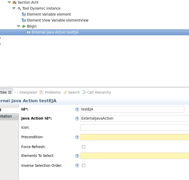

In the odesign I added an new tool that call the java Action :
index.php/fa/25474/0/
Everything seems fine to me but when I try my tool on the diagram I got a cross instead of the selector. It seems like it can't access to my class from the diagram.
Any idea ?
Regards.
