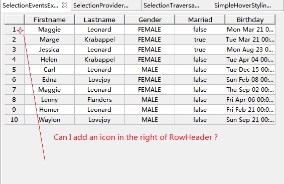

Hi, Dirk,
Can I add an icon into RowHeader like attached image ?

Re: Can I add an icon in RowHeader in NatTable ? [message #1727595 is a reply to message #1727594] Thu, 24 March 2016 05:32 Go to previous messageGo to next message
Yes, it is the same as for body cells. You simply need to register the appropriate cell painter for the row header. Dependen on your use case it can be done via CellPainterDecorator.
