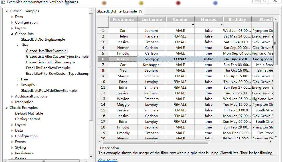

I'm sorry, I didn't make it clear. Ok, in GlazedListsFilterExample, by following steps
1. Select a row(click row number), the row was selected.

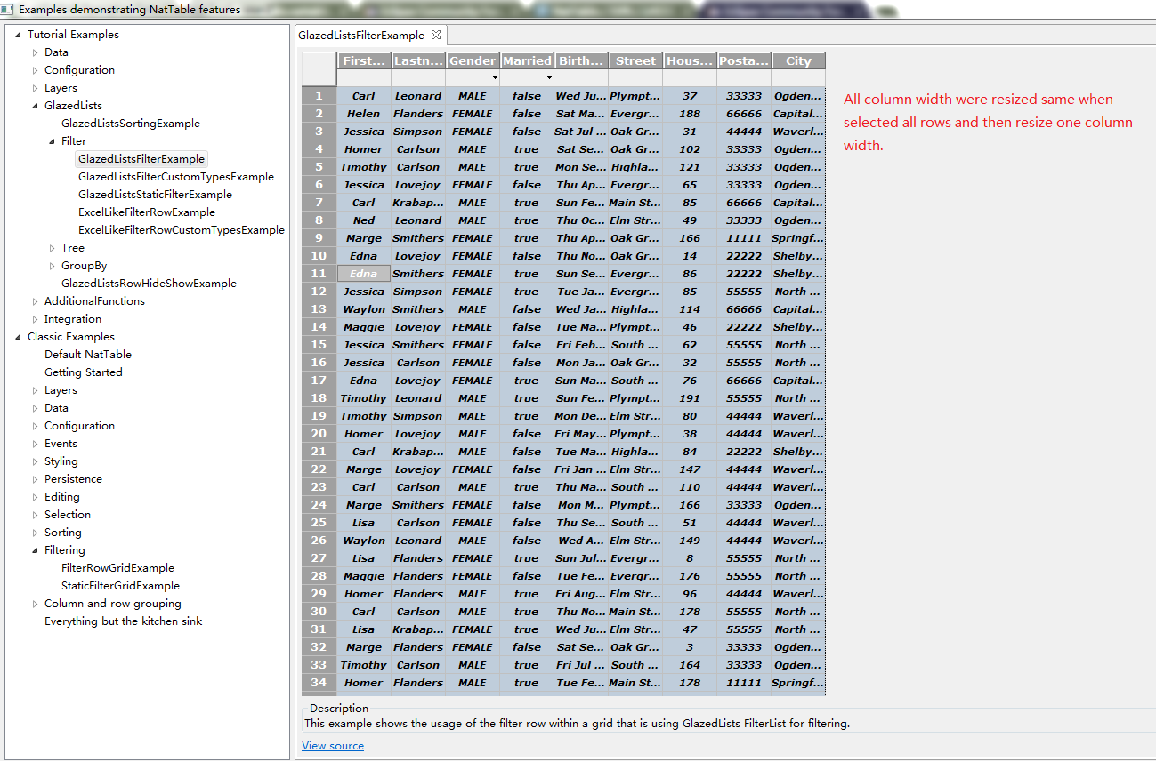

2. Press Ctrl + A, all rows were selected.

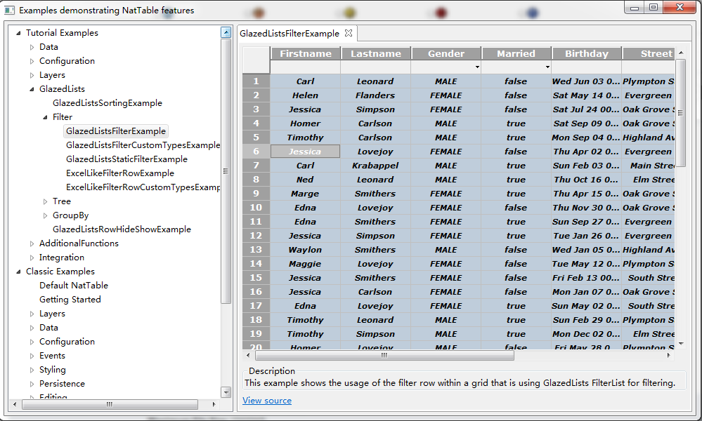

Another question, when I select all rows, then resize one column width, all column width resized, is it the right behavior? Or, is there any solution to help me only resize one column with when selected all rows? Please see Setp_3.png
