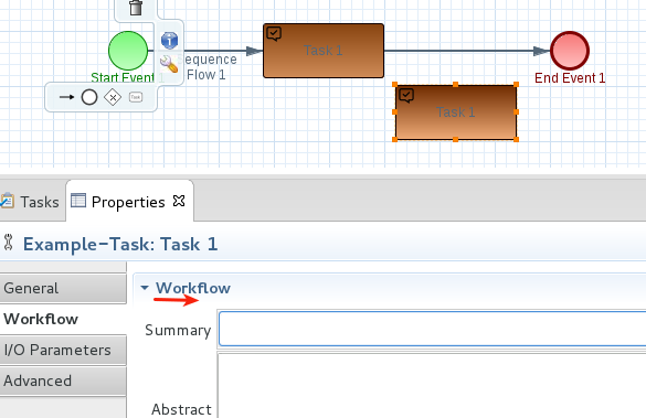

there is a strange behavior by my own implementation of a customTask element with a customPropertySection.
The customTask element implements a customPropertySection and binds a new attribute called 'processid'
public void createBindings(EObject be) {
setTitle("Workflow");
// ProcessID
this.bindAttribute(attributesComposite, be, "processid");
index.php/fa/25284/0/

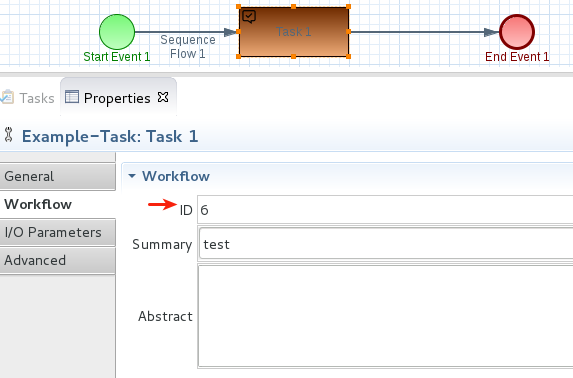

In XML the task/attribute definition in bpmn looks like this:
<bpmn2:task id="Task_2" imixs:processid="6" name="Task 1">
So far, everything works.
When you now do a copy&past of this element the id-editor is not rendered (see screen2.png)
index.php/fa/25285/0/
Closing the editor and reopen it - everything works again fine.
This behavior exists since a long time. So I did not think it is related to latest changes in 1.2.3. I can't figure out what is wrong. I guess something in the implementation of the customTask element is wrong in general?

Hi Ralph,
Congratulations, you've found another bug Wink
This is actually caused by the Paste function in DefaultPasteBPMNElementFeature.copyEObject(T eObject). Normally when a new object is constructed (i.e. during loading, or creation through the tool palette) the object is passed through the ModelExtensionDescriptor which adds metadata to the ExtendedPropertiesAdapter for extension features (the "processId" in your case). This does not happen during the Paste operation because...well, I just forgot to handle it.
I have a patch that fixes this easily and with no obvious side-effects. At the end of copyEObject() just before the return t; add these lines:
		ExtendedPropertiesAdapter<T> oldAdapter = ExtendedPropertiesAdapter.adapt(eObject);
		ExtendedPropertiesAdapter<T> newAdapter = ExtendedPropertiesAdapter.adapt(result);
		for (EStructuralFeature oldFeature : oldAdapter.getExtensionFeatures()) {
			FeatureDescriptor fd = newAdapter.getFeatureDescriptor(oldFeature);
			fd.setProperty(ExtendedPropertiesAdapter.IS_EXTENSION_FEATURE, Boolean.TRUE);
Can you please file a bugzilla so we can track this bug?
Thanks!
Bob
