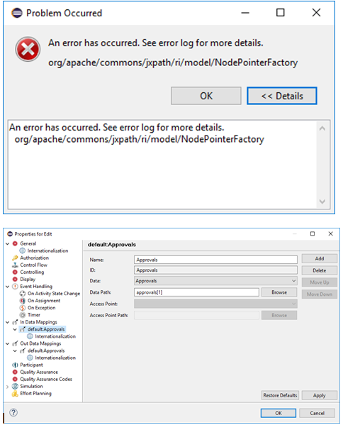

I have Structured Data that contains a sequence of records: An Array of Approvals, in XML it would look like this:
<Approvals>
  <Approval>
     <Approver>Bob<Approver>
     <Approved>true</Approved>
  </Approval>
  <Approval>
     <Approver>Job<Approver>
     <Approved>false</Approved>
  </Approval>
</Approvals>
I want to have a manual process to edit the first entry.
I set the In & Out Data Mappings/Data Path to:
approvals[1]
and I get the following error when I debug in Eclipse:
An error has occurred.See Error log for more details.
   org/apache/commons/jxpath/ri/model/NodePointerFactory.
index.php/fa/24825/0/
  • Attachment: Capture.PNG
    (Size: 97.96KB, Downloaded 507 times)

Roger,
we need to create ticket for this. Please try if this works in the web modeler + runtime as expected. You will find that the roundtrip there is also pretty fast.
Rob
