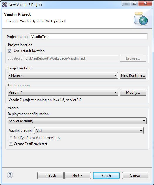

I am trying to deploy Vaadin 7 application on Virgo server trough Virgo Tools.
I am using Vaadin Plug-In for Eclipse version 2.3.6 to create the vaadin project (VaadinProject.PNG).

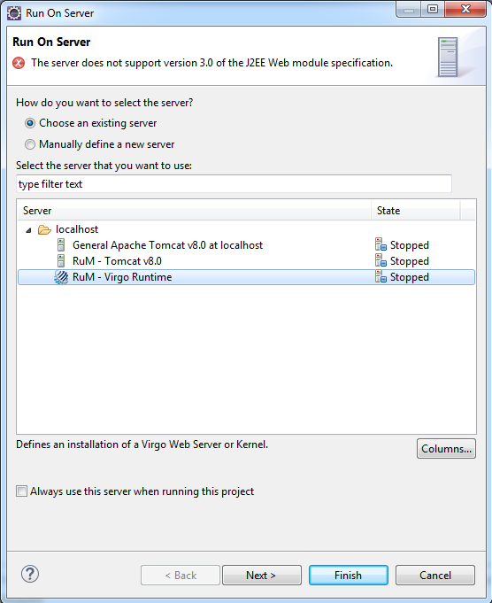

When i try to ron the application on Virgo server, then i get a message "The server does not support version 3.0 of the J2EE Web module specification."

If I understood correctly, you created a Web project using the Vaadin plug-in for Eclipse and then tried to deploy it to a Virgo server using the Virgo tools.
Unfortunately this use case is not supported.
If you want to develop for Virgo using the Virgo Tools you have to use the Virgo Tools for creating projects and not the Vaadin plug-in for Eclipse.
The Virgo Tools provide a wizard for creating Bundle Projects. The same wizard can also create a Bundle Project that is a Web project. Bundle projects have different characteristics from dynamic Web projects created using the Vaadin plug-in wizard and unluckily Virgo Tools support only Bundle Projects.
To use Vaadin in Virgo you must first create a Bundle Project, then you can add the Vaadin JARs as nested JARs and finally use the MANIFEST.MF editor to list such JARs in the bundle class path.
You'll have to setup the Vaadin servlet in web.xml by yourself but you could start by comparing the sample web.xml created by the Vaadin plug-in.
If I am not mistaken you also opened a bugzilla entry for this problem. If you confirm that the Web project was created with the Vaadin plug-in for Eclipse, then I think that the defect should be closed as invalid.
GianMaria.
