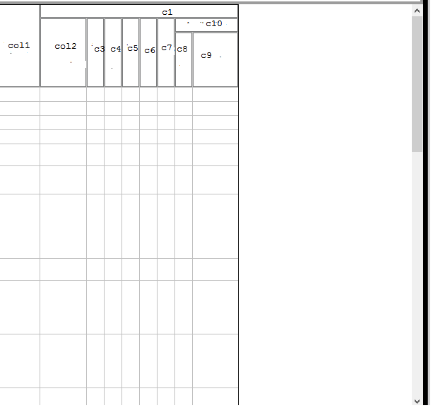

Re: Nattable column resize [message #1719965 is a reply to message #1719962] Wed, 13 January 2016 08:52 Go to previous messageGo to next message
I have attached sample nattable file (edited the column names in paint, so it doesnt look good).
If you can see, in that there is a white space betwen the last column and the scrollbar. This is what happens when I resize it. The expected behaviour is, it should resize every column and fit to the composite perfectly without white space.

Re: Nattable column resize [message #1719966 is a reply to message #1719965] Wed, 13 January 2016 08:54 Go to previous messageGo to next message
Why don't you use percentage sizing in that case?
