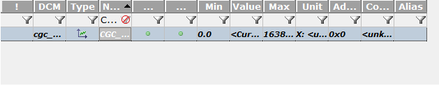

Today i came across an issue with nattable.
After applying a filter if i try to resize the coulmn width of any column in my table with the help of mouse, all the columns are getting resized to the same width.
I am wondering why this issue occuring.
Can someone help me?

IIRC this could be related to an issue that has been found in 1.3.0
Could you please try to test this with a current 1.4.0 SNAPSHOT? I think I fixed this. And IIRC it was related to a wrong determination of the columns within the CompositeLayer. But I'm not 100% sure right now.
