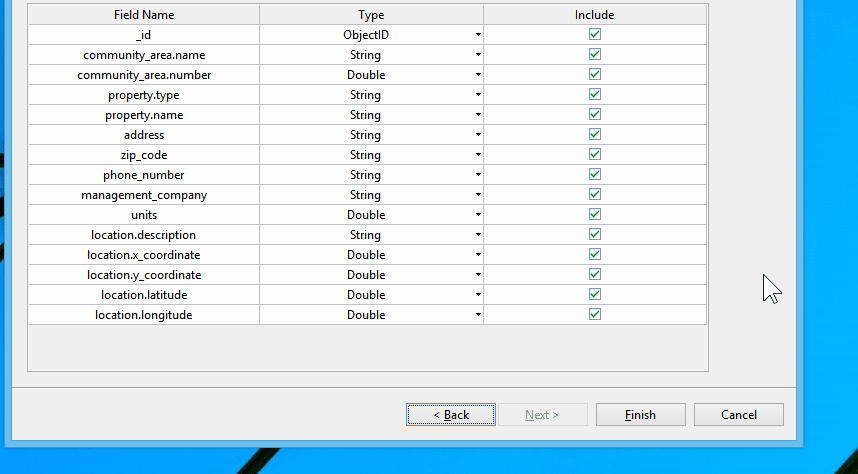

I have a strange problem when creating a table where columns width are set in percentages:
bodyDataLayer = new DataLayer(bodyDataProvider);
bodyDataLayer.setColumnWidthByPosition(0, 34);
bodyDataLayer.setColumnWidthByPosition(1, 33);
bodyDataLayer.setColumnWidthByPosition(2, 33);
bodyDataLayer.setColumnPercentageSizing(true);
Video is attached, also here:
https://drive.google.com/file/d/0B2Ajd8pcJvUjbnNDUGUyT1pDWEU/view?usp=sharing
After creation of a table the columns do no grab 100% of space and there is a bit of horizontal space left. As soon as I resize in vertical direction, the columns correctly span the whole horizontal space. After some debugging I can see there is something strange with the size calculation. In particular in function DataLayer::doCommand() clientAreaResizeCommand.getCalcArea().width returns the initially incorrect size (off by 15) , and the value jumps by 15 straight after resize event. Am I doing something wrong? Or is it a bug?

All right, updated to the latest snapshot 456, is solved the above mentioned problem, but the new one appears in this build, even nastier (on windows 10, macos is OK). When I try to decrease the size of the table, I get the attached effect and the spinning wheel of death.
