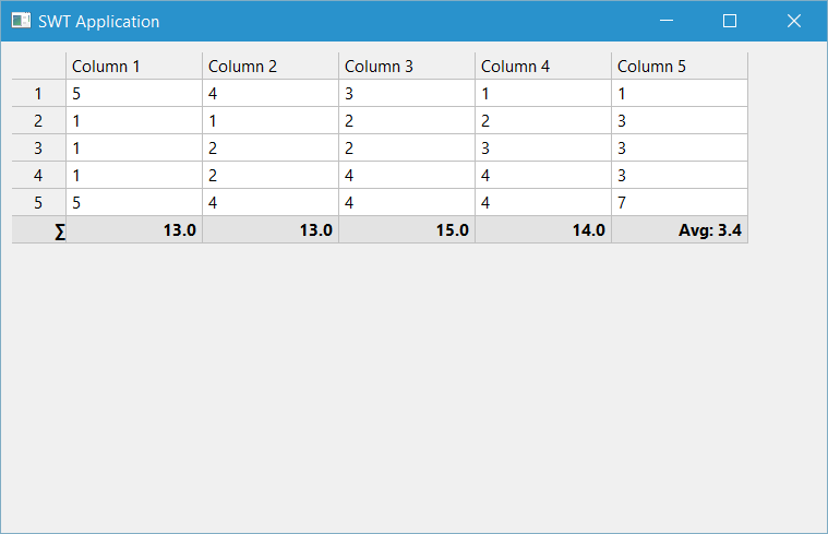

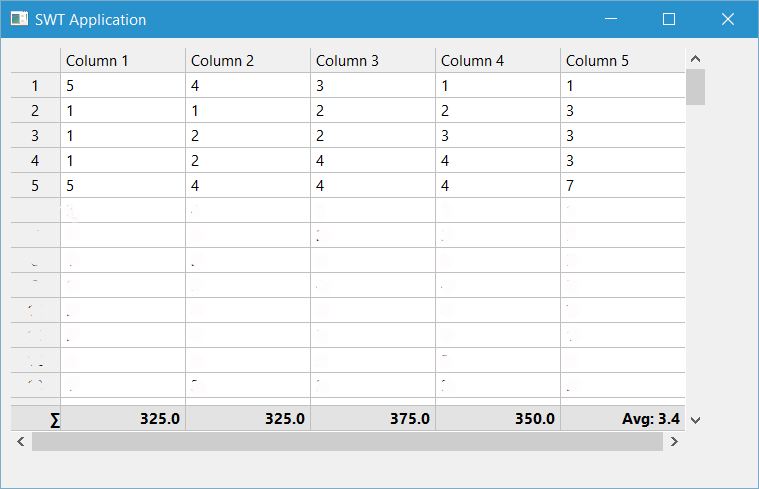

Re: FixedSummaryRowLayer [message #1723950 is a reply to message #1715340] Fri, 19 February 2016 03:30 Go to previous messageGo to next message
if the table few records, it looks like this: index.php/fa/25045/0/
How can I do to FixedSummaryRowLayer remained at the bottom, like this: index.php/fa/25046/0/

Re: FixedSummaryRowLayer [message #1723997 is a reply to message #1723950] Fri, 19 February 2016 10:13 Go to previous messageGo to next message
This is not supported
