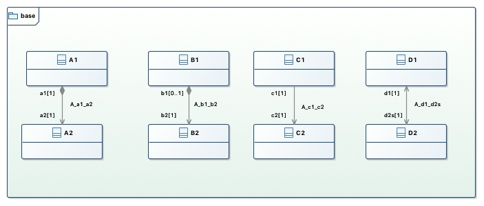

Since I have experienced similar situations, I did the following Java code generation experiment, focusing on relationships between classes (how they are translated into Java code).
Input (class diagram created with UML Designer):
index.php/fa/24006/0/
Output (generated code, e.g. for class A1):
	 * Returns a2.
	 * @return a2
	public A2 getA2() {
		return this.a2;
	 * Sets a value to attribute a2.
	 * @param newA2
	public void setA2(A2 newA2) {
		if (this.a2 != null) {
			this.a2.set(null);
		this.a2.set(this);
The issue is on
this.a2.set(null);
and
this.a2.set(this);
. This was already reported by Victor:
- Uml to Java issue [message #1713795]
- Bug 481751 - Association generation incomplete
In my experiment, this pattern appears for class A1, B1, C1, D1 and D2. It seems something is wrong with this code generation for composition, reference, and association.
Best,
Akira
