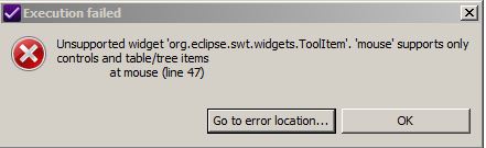

The control is get-control Any -index 12 when perform a right mouse click on that I open a context menu.
If I use the following portion code nothing happend .
get-control Any -index 12 | mouse down -button Right |click
get-control Any -index 12 | mouse up -button Right | click
I try also to change the code
get-button "Messaging perspective" |  mouse up -button Right | click
In this case I receive an error because it is not a "control".
index.php/fa/23854/0/
Have you got any got tip ?
