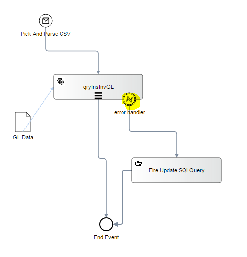

I have a Use Case to read some data from CSV and insert data if the data is not present and update it if a record exists for the existing row.
I got the Following sample which helped me to start understanding how to read from CSV using Camel and Insert but what I noticed is it just keeps on inserting record but not update it if value already present.

I did not try this but i think it is possible in following ways:
1. Your table structure should define one column as a primary key.
2. When SQL application will try to insert the records with duplicate key it will get some SQLException.
3. Add and error event(Boundary error event) to catch that exception and in exception flow try to fire update query.
Your process should look something similar to below(this is just a dummy scratch)
index.php/fa/23733/0/
You can refer below documentation how to add "Error Boundary Event"
http://help.eclipse.org/mars/index.jsp?topic=%2Forg.eclipse.stardust.docs.analyst%2Fhtml%2Fhandbooks%2Fmodelling_analyst%2Fpep-events.htm&resultof=%22boundary%22%20%22boundari%22%20%22event%22%20
See section Error Boundary Event - Implementation
Rajkumar
