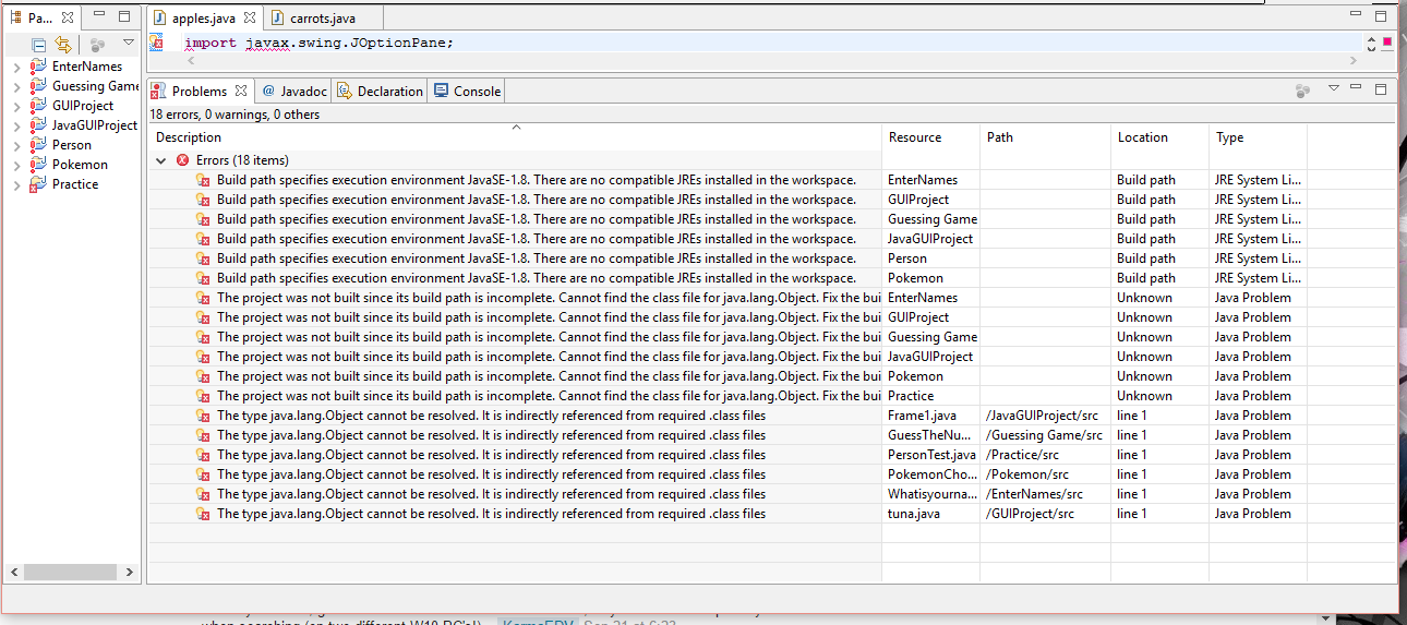

Hey everyone,
SO I have Andriod studio and eclipse luna installed on my computer. I upgrades AS and then Java on my computer and now I am getting errors when I run eclipse projects.
Below are some screenshots. Any advice?
thanks in advance! Smile

The image doesn't actually show a message when trying to run your code.
Upgrading Java can remove old versions that Eclipse knew about. Eclipse won't know about newly installed versions unless you tell it.
In order, make sure everything points to a valid JRE on the Installed JREs preference page, the nearby Execution Environments preference page, the JRE System Library entry on every Java Project's Java Build Path (use the Package Explorer or the project's Java Build Path property page), and then the individual launches in the Launch Configuration Dialog (Run->Run...).
Referring to the JRE by using an Execution Environment in the project's Java Build Path and in your launchers will save you from having to review those again later under similar circumstances.

Thanks for the reply.
The error I get when I run the app is JRE Java-CDC does not support debug mode.
How will I be able to specify JRE build path for eclipse? Thats the issue but I don't know how to point eclipse to the path of the JRE

Some of those messages require that you have a Java 1.8 runtime installed. You would set that up from the Installed JREs preference page. A project's Java Build Path can be modified from the Properties dialog for the project. You can open that by selecting the project and choosing Properties from its context menu or from the Project menu in the menu bar.
