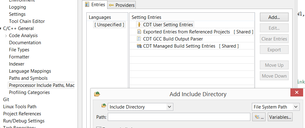

Note that there are no include paths in the image you provided.

Here are my settings for Cortex-M4, modify to suit yours:
Preprocessor Include Paths, Macros etc:
Providers
Remove check from CDT Cross GCC Builtin Settings
This gets rid of i386/i686 stuff
Entries / GNU C
CDT User Setting Entries
Add /usr/lib/arm-none-eabi/include
Add /usr/lib/gcc/arm-none-eabi/4.8.2/include
Add /usr/lib/gcc/arm-none-eabi/4.8.2/include-fixed
Add paths to your own header directories
Paths and Symbols
Include files
Add cortexm4-predef.h
The target processor predefine header file is generated
by the GCC in use:
arm-none-eabi-gcc -mthumb -mcpu=cortex-m4 -E -dM </dev/null >cortexm4-predef.h
The Project properties page wants to re-index after changes, let it do so.
