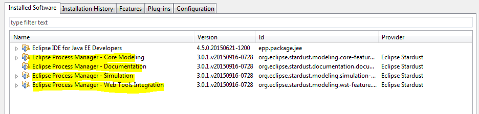

Can you double check if Stardust installed properly ? like do you see all below items in already installed ?
index.php/fa/23672/0/
