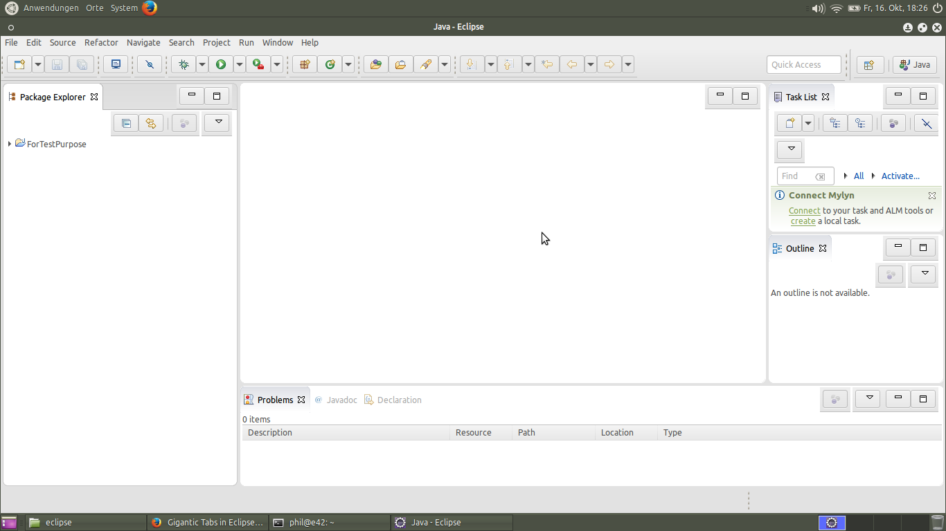

I have a Problem with my Eclipse appearance.
When i start Eclipse for the fist time it looks like this and everything is fine.
index.php/fa/23574/0/

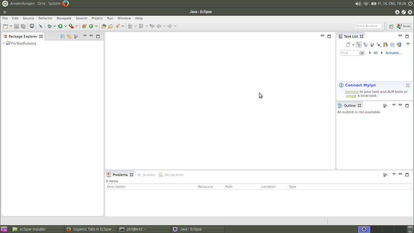

But when i start eclipse for the second time it looks some kind of creepy.
index.php/fa/23576/0/
Iam using Ubuntu Mate 15.04 and Eclipse Mars.1 .
Can somebody tell me why this happen ?

I had the same problem.
I "solved" it by adding the following in eclipse.ini:
--launcher.GTK_version
2
And used Jeeeyul GTK 2 wizard to fix this (https://github.com/jeeeyul/eclipse-themes/wiki/Linux-Huge-Toolbar-Problem).
The Jeeeyul plugin can be found here: https://marketplace.eclipse.org/content/jeeeyuls-eclipse-themes
Gook luck!
