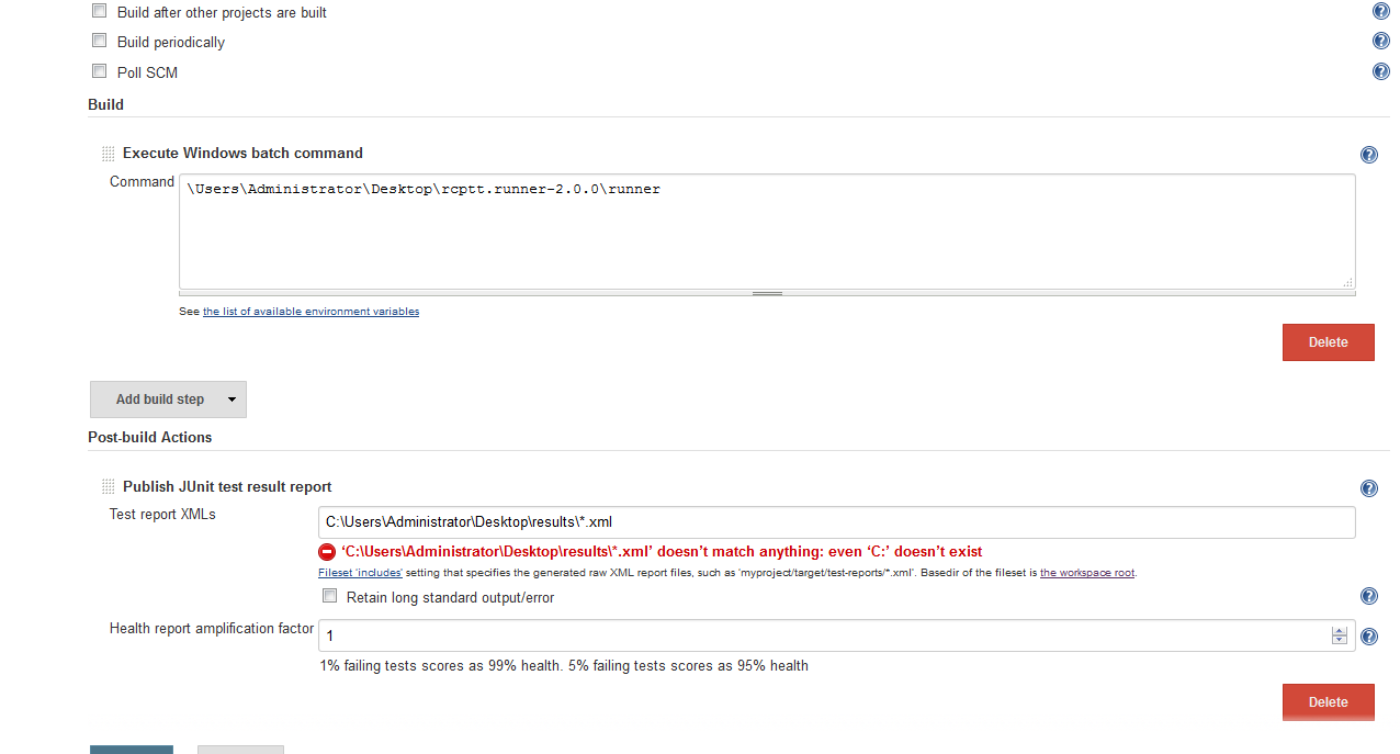

I'd like to run a simple rcptt test case before to set up Maven and Subversion.
I'd like to go ahead step by step because I am newbie using both of them.
1. I have created a runner.cmd and it works from DOS shell.
2. I set up a Jenkins Job using the runner.cmd (and the report parameter inserted into the runner.cmd)
Jenkins look like don't recognize the link about the report.
index.php/fa/23382/0/
3. When I run the job it started but it is not able to open the AUT (Application Under Test) in the server and run the test case.
It is blocked on
-Dorg.eclipse.swt.browser.IEVersion=9999

  • Attachment: confJob.PNG
    (Size: 36.77KB, Downloaded 1030 times)
