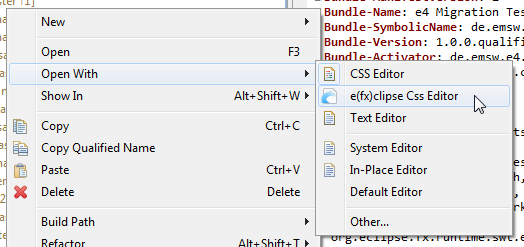

Hi guys,
I am pretty new to e(fx)clipse and since I am using Eclipse Luna 4.4.0, I installed version 1.0.0 (including the XText).
After done with installation, I created a new JavaFX project.
I then opened the src > application and found two files: Main.java and application.css. In some of installation videos I have watched, they have their application.css with the CSS Editor icon, but mine has the Sublime Text icon (I made Sublime Text my default text editor for html and css files).
I tried right clicking the file and look at the applications available in open with option, but there is no e(fx)clipse CSS Editor option (i.e. only Text Editor, System Editor and Default Editor). I have attached two pictures in which one shows a normal working CSS Editor file opener and the other one is from my project explorer.
I would be very grateful if you could help me with this matter. Thank you very much

Why did you use 1.0.0 - if there's already 1.2.0 which is compatible with Luna? You can check through the host console (in your console view what state the e(fx)clipse bundles have by issueing "ss org.eclipse.fx" )
