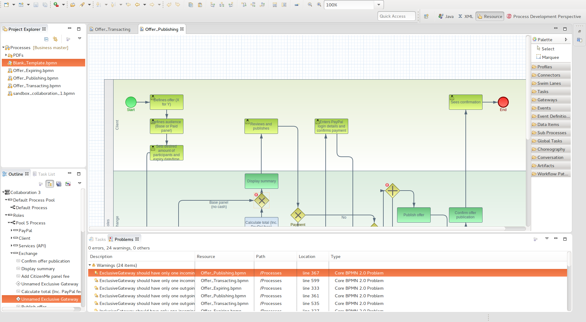

I seem to have a problem with the BPMN2 modeller on Eclipse Mars and OS X Yosemite. Everything works well, except that warnings and errors for a diagram I'm creating aren't being displayed. A colleague of mine who's running Ubuntu 15.04, the same version of Eclipse and its modules is managing to see the errors so I can be certain that they're there.

I've attached a screenshot of my colleague's warnings as an example.

Hi Matt,
Validation is only done if the project has the BPMN2 nature and BPMN2 builder defined. When you first save a BPMN2 process, the editor should ask if you would like to install that nature and builder if they're not already there. You can also install them manually through the eclipse project preferences.

Hi Matt,
Validation is only done if the project has the BPMN2 Nature and Builder installed. When you save a BPMN2 process the first time in a new project, the editor should ask if you want to install the nature and builder if they're not already there. You can also install them manually from the project preferences page.
