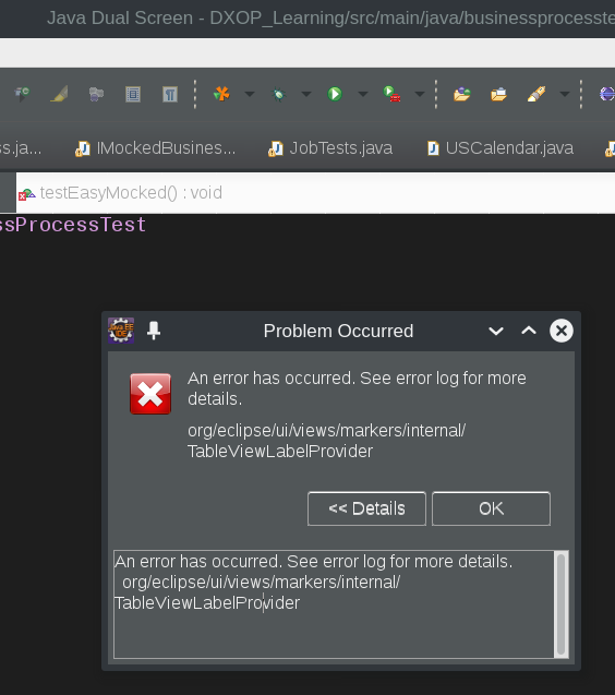

Hello all,
I have a copy of eclipse open that, every time I try to close it, instead of closing, it pops up this error:
https://www.eclipse.org/forums/index.php/fa/22753/0/
Here is the stack trace from the workspace/.metadata/.log file:

Re: Eclipse Mars won't close when telling it to, instead pops up an error about TableViewLabelProvid [message #1703755 is a reply to message #1703749] Tue, 04 August 2015 13:27 Go to previous message
Please update to Mylyn 3.16 which fixes this issue.
