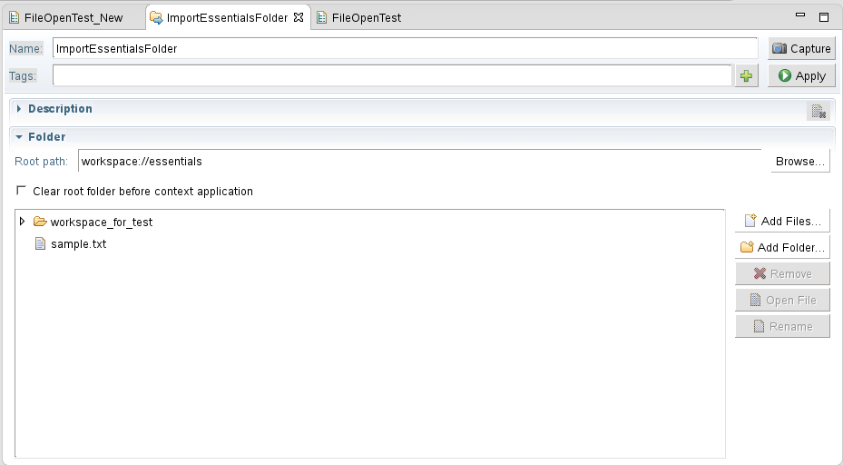

I have a Folder context to copy sample.text into essentials directory using
workspace://essentials
option in Folder context
The file is also copied properly as you can see here:
vl-c-jrex-ice{571}> pwd
/prj/iceng/qsip1/workspaces/c_jrex/TestPlan/aut-QSIP-2
vl-c-jrex-ice{572}> ls
essentials/  logs/
vl-c-jrex-ice{573}> ls essentials/
sample.txt  workspace_for_test/
vl-c-jrex-ice{574}>
I have also attached screenshot of Folder Context.
Can you please guide me in this ECL? I need a way to access workspace in the form of an absolute path, when printed.
