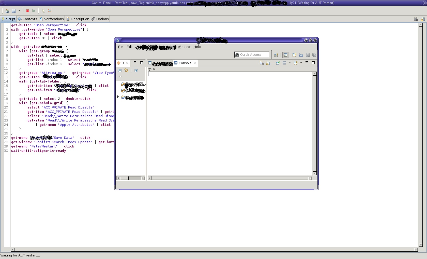

I have test scenario, in which I have to restart my AUT (File->restart) While recording I go to file and then restart, the application gets restarted but the control panel of recording says waiting for AUT to restart and it doesn not record the actions done on AUT.

Could you please try to save this snippet to the test and click Record? What is the result?
Could you please just replay this snippet as a test case and send us rcptt log and html report?
To get HTML report click "Report" in Execution view -> choose HTML format and set location-> Finish.
