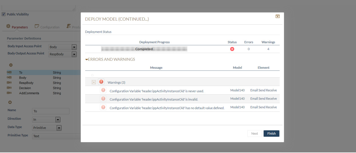

Hi Rajkumar,
Thanks for the files!
When I am deploying this process I am facing some errors!
Errors and Warning:
1. There is no IPPActivityInstanceOID (Warning)
2. If I ignore all the warning and deploy the process, there is execution error
index.php/fa/22651/0/

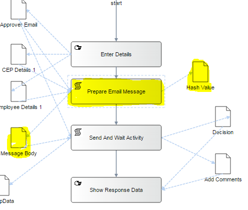

Re: [File missing] Camel Route to Send and Receive Email [message #1702737 is a reply to message #1702732] Fri, 24 July 2015 07:48 Go to previous messageGo to next message
Hi Kunal,
Error "java.lang.IllegalArgumentException: No script engine could be created for: rhino-nonjdk" is related to javascript scripting engine because it is not by default shipped with stardust. But as you said you manually copied all the jars then it should work.
Anyway in this process there is only one application activity named "Prepare Email Message" which uses javascript engine. You can get rid of that activity and use another activity may be manual activity to populate "Message Body" and "Hash value" data. Then in that case you should not get this error.
