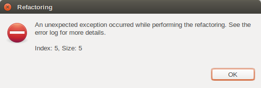

Cleanup is not working. It shows an error Message.
index.php/fa/22525/0/

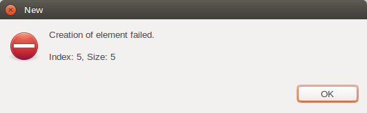

If you create a new class (or JUnit Testcase, what indeed also is a new class), you get an error message. The file was created, but is completely empty.
index.php/fa/22526/0/

I'm sorry. I should start thinking before posting.
Just after writing this, I thought about what if Project Lombok is the reason.
To test I removed lombok from eclipse.ini and the errors are gone.
Sorry for blaming the wrong tool.
