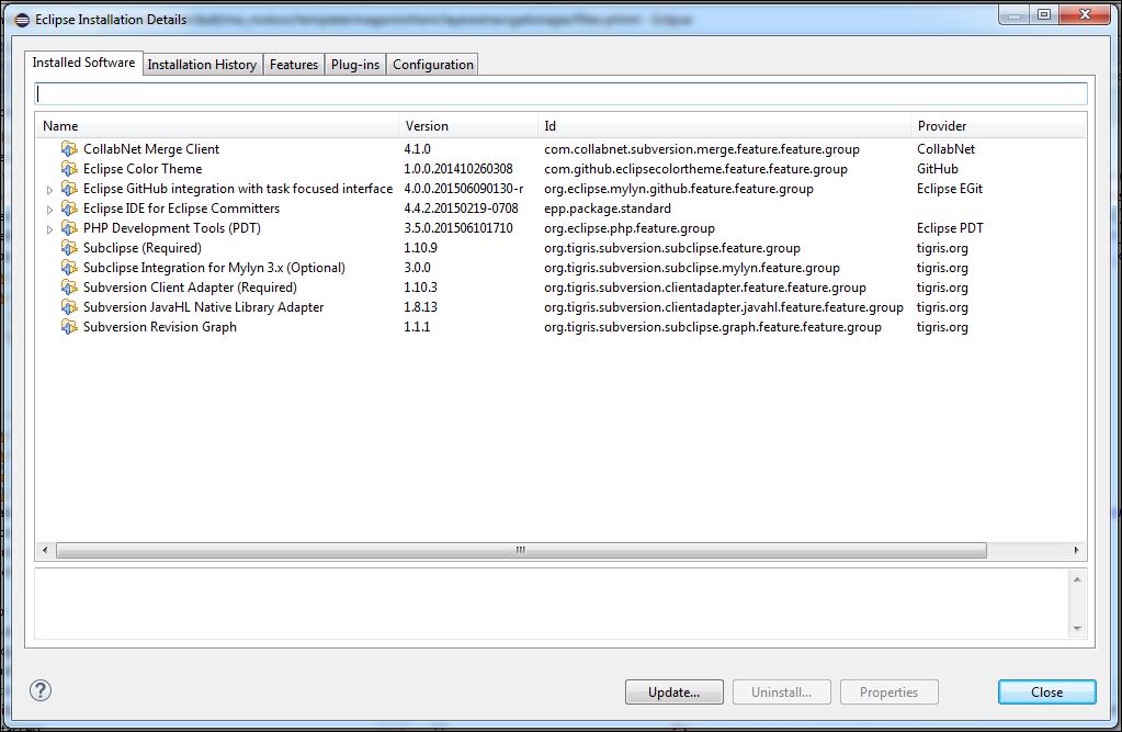

Re: Added Mars update site but 'No updates were found' [message #1700645 is a reply to message #1700584] Mon, 06 July 2015 04:12 Go to previous messageGo to next message
Hi Eike,
Many thanks for the assistance on this. Screenshot attached....
Andy

Re: Added Mars update site but 'No updates were found' [message #1700911 is a reply to message #1700645] Wed, 08 July 2015 03:07 Go to previous messageGo to next message
Am 06.07.2015 um 10:12 schrieb Andy Ingham:
> Hi Eike,
Okay, that explains it. The "epp.package.standard" product is discontinued after Luna, so you can't update that IDE.
It's odd but please install a new one.
