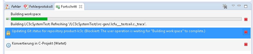

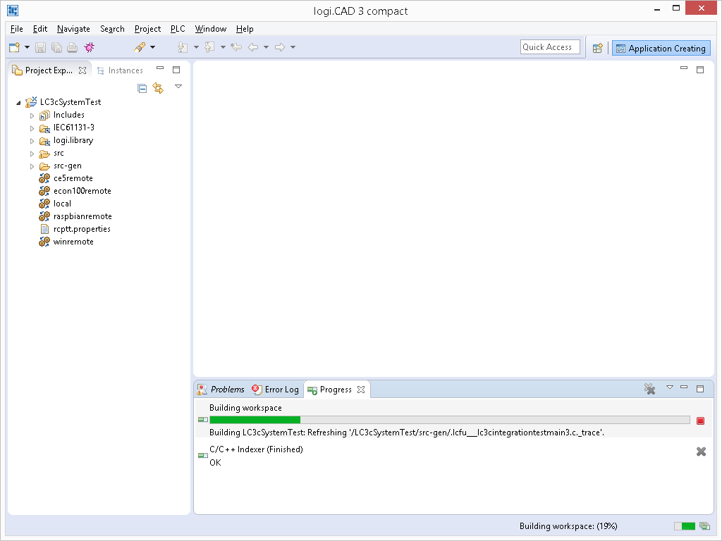

We have a DSL from which we generate C-Code (.c and .h files). The project build (especially on Windows platform) is very slow mainly due to refreshing and indexing (by Eclipse CDT) mysterious trace files.
Currently we don't know which part of the framework is responsible for generating these trace files (CDT, XText, Eclipse, whatever ...).
We were not able to analyse the content of the trace file, since none of the files appear at the file system.
The filename syntax is as follows:
For a C source code file "/project/src-gen/my_c_function.c" the following trace file gets generated: "/project/src-gen/.my_c_function.c._trace"
Does anybody know if XText is responsible for this ?

Re: Strange trace files after code generation! Are they generated by XText? [message #1700135 is a reply to message #1699863] Tue, 30 June 2015 07:17 Go to previous messageGo to next message
*._trace Files were associated with a "Trace File Viewer". We have no clue what this is or where it comes from. I have removed this file association, but this didn't help (see screenshot).
Another very strange thing is that the trace files (like the one shown in the screenshot) do not exist in the file system.
Is there a way to deactivate this trace file handling in the XText generator framework?

Re: Strange trace files after code generation! Are they generated by XText? [message #1700349 is a reply to message #1700241] Thu, 02 July 2015 01:58 Go to previous messageGo to next message
Many thanks for your support so far.
Debugging the code gave us some new information. Our generator does not create the trace files but the XText framework tries to access trace files for generated code during the build process. During this process, XText checks the existence of each trace file and if they do not exist, it simply continues.
The problem is that we are using Git (EGit) for our projects. For any reason, EGit wants to refresh the Git status of the trace files and produces nice "hangs" (sometimes minutes for a single "non-existing" trace file).
We have tried several patterns for the trace files in our .gitignore file with no positive effect.
Is there anybody outside who can help us to make at least a small step forward?
