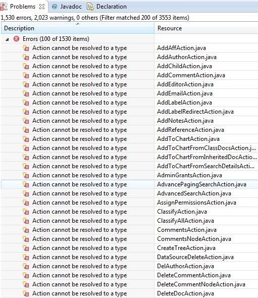

Re: Reviving an old project [message #1700190 is a reply to message #1700069] Tue, 30 June 2015 10:50 Go to previous messageGo to next message
Attached an image of some of the erros:
index.php/fa/22358/0/
  • Attachment: errors.PNG
    (Size: 52.01KB, Downloaded 186 times)
Re: Reviving an old project [message #1700228 is a reply to message #1700190] Tue, 30 June 2015 23:21 Go to previous messageGo to next message
I'm unfamiliar with these APIs, but I can confidently state that they
have nothing to do with Tomcat. Tomcat-Eclipse is not your problem.
You're simply missing some other library, likely a sort of presentation API.
Your old project should contain some clues. I'm not seeing enough of the
error messages to know what the package names are so I've been unable to
ascertain what library is missing.
Re: Reviving an old project [message #1700329 is a reply to message #1700228] Wed, 01 July 2015 17:44 Go to previous message
You are right, the errors presented are from a library specific to the project.
I went through the code and most of the errors are missing references to STRUCT.
I'm trying to follow the path of using the latest eclipse to compile the project. I'll try to keep posting progress.
