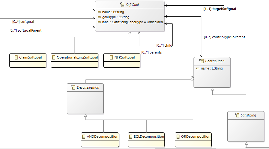

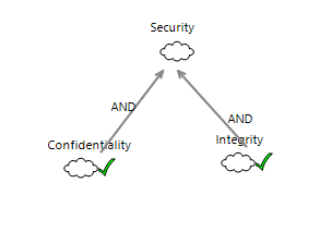

I'm trying to implement a label propagation mechanism which means that if a element's value is changed, then corresponding parent's label will be changed automatically depending on children siblings' relationship.
For example, in the following diagram,
index.php/fa/22241/0/
if the labels fo "confidentiality" and "integrity" will be changed into "satisficed", then the label of their parent "security" will be automatically changed into "satisficed". I think this needs to use Java Extension, how can I use it?

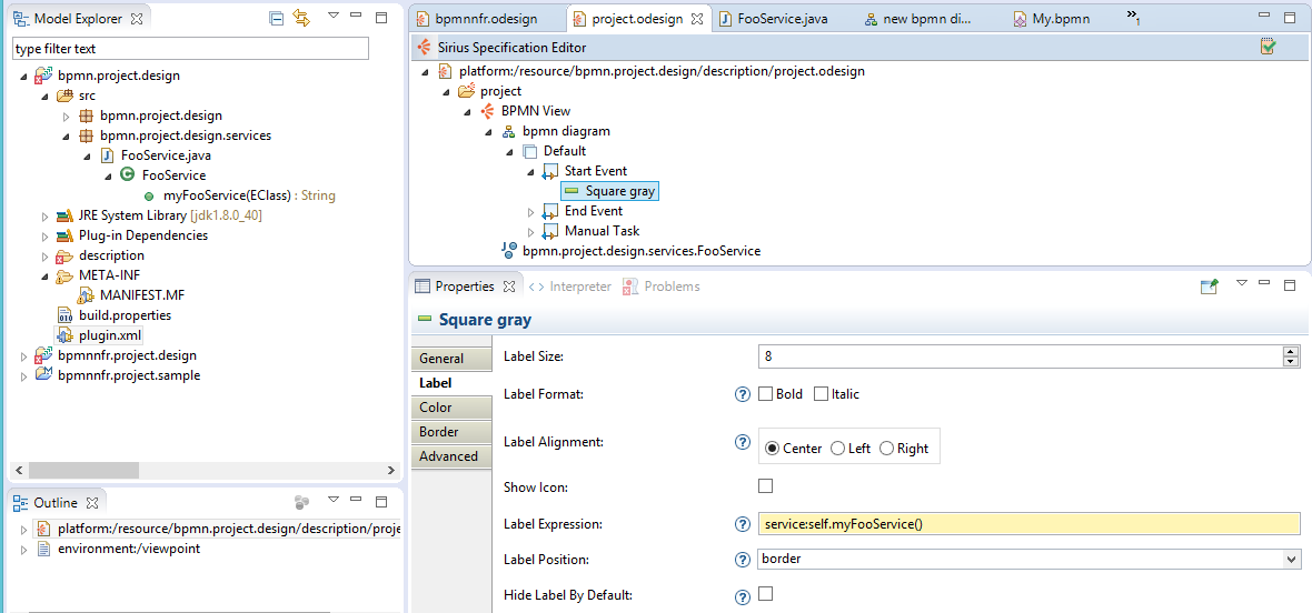

I tried to use the Java Service. Like the previous post(how to call a Java Service, I follow the instruction, but my odesign file cannot recognize my defined java service.
Here is the example.index.php/fa/22275/0/
I also read the article[1].
I don't know why my odesing file cannot find java service.
Could someone help me?
Thank you so much.
