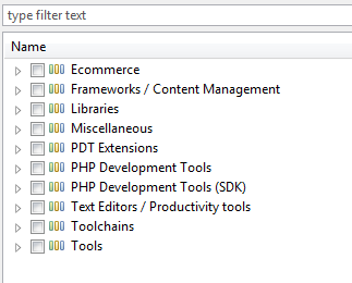

A while ago I asked about variable warnings, now I am trying to do a clean install again, and I want to get my warnings back.
So I headed over to the pdt-extensions site, entered the url in my "Available Software Sites"
But none of the options I see seem to fit the advice given a few months ago.
index.php/fa/22140/0/
If I select "PDT Extentions" then I get errors, (basically there is a conflict in dependencies).
I got the latest eclipse from, https://eclipse.org/pdt/ and then tried to install the extensions.
What am I missing here?

Latest Core-Plugin require minimum PDT 3.5 (current nightly, will be released together with mars). Both, 3.5 and DLT 5.2 are available in http://p2-dev.pdt-extensions.org/., so please also select category "PHP Development Tools", and "contact all sites during update".
