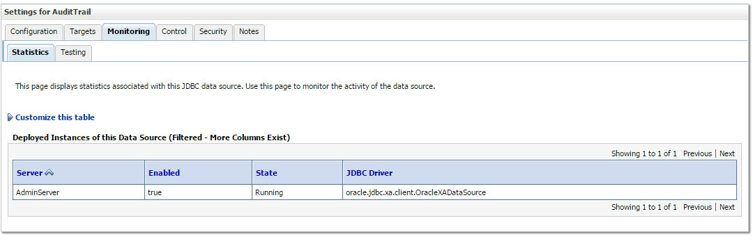

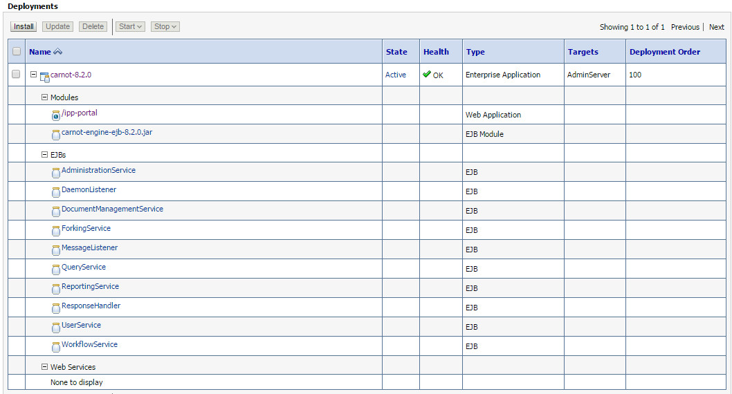

I just successfully deploy carnot.ear to Weblogic 12c and connecting with Audit trail (Oracle 11g) done also:

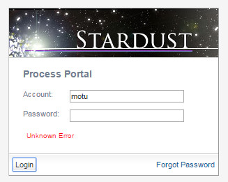

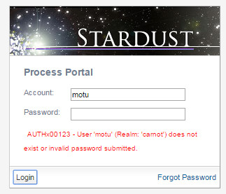

But when I login into IPP Portal using "motu" user, it message to me "Unknown Error" (if I type password: "motu"), in case I type wrong password It show: "AUTHx00123 - User 'motu' (Realm: 'carnot') does not exist or invalid password submitted."

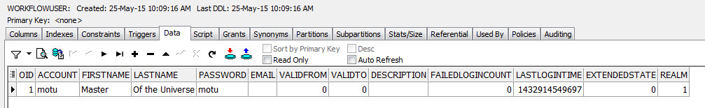

Here 's WORKFLOWUSER table in my audit database:
index.php/fa/22010/0/
I try some way but currently Idon't know how to resolve this problem, so please help me.
