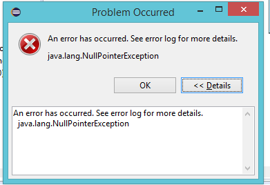

This is the error log.
I hope this would be help.
Thanks alot.
Eunjung Park

Re: a node label cannot be saved when using Node Creation from a Palette. [message #1697192 is a reply to message #1697191] Tue, 02 June 2015 05:31 Go to previous message
Le 02/06/2015 11:12, eunjung park a écrit :
> Hi,
> Thanks alot.
> Regards,
> Eunjung Park
Thanks but what I need is the full stack trace, the class of Exception
is not enough to understand the issue. Perhaps you are not aware about
what a stack trace is, so read this article[1]
[1]
http://stackoverflow.com/questions/3988788/what-is-a-stack-trace-and-how-can-i-use-it-to-debug-my-application-errors
