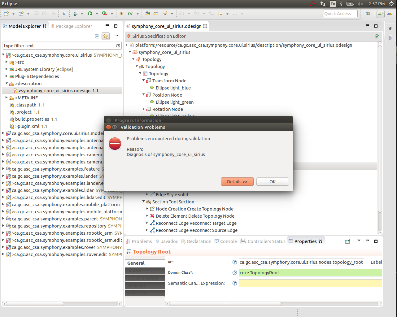

I'm relatively new to Sirius; in fact, I was just introduced to it for the first time two or three weeks ago. While I have gotten a pretty good grasp of how to use Sirius , I've been running into a serious issue where I'm getting a bunch of errors during validation. To be specific, when I attempt to validate my .odesign model (or in some cases, when I try to create a new diagram representation), I get a number of errors saying:
"Invalid Type: viewpoint::DragAndDropTarget"
The issue is that it sometimes causes the generated diagram representation to appear incorrectly; I say sometimes because there have been some cases when the outcome is correct. When it doesn't work, I literally have to restart Eclipse in order to try to fix it; nothing else seems to have any effect. That being said, having to do so every couple of minutes quickly becomes frustrating and hurts my productivity.

while that isn't a bad idea, the issue is that I never actually refer to the type DragAndDropTarget in any of my expressions; I simply haven't needed to use such a type in order to accomplish what are fairly standard operations. If I had explicitly used it somewhere, then I could potentially understand the errors that I'm getting but I never do; that is what makes it so mysterious...
Upon careful inspection, it appears that the validator is complaining at the precondition expressions in the node / edge diagram elements; once I remove the expressions, the error goes away. I have no idea why something like "[self.oclIsKindOf(GroupNode) = false/]" is causing the Validator to throw errors about DragAndDropTarget; the expressions are valid and behave as expected. "self" in this context refers to the element of the given type being tested and is required to prevent multiple nodes in the diagram from being created for one particular semantic element; essentially, I'm dealing with a large type hierarchy where I only want the most specific node possible being created for each semantic element.
Any idea why the validator dislikes these expressions? Am I doing something wrong?
