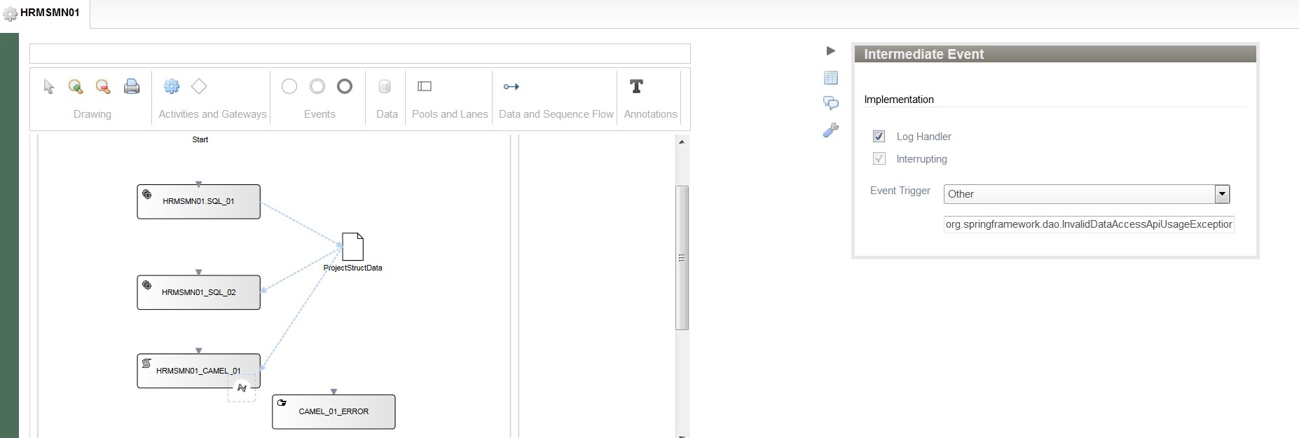

I have a few modeling questions in particular about exception handling for Camel Producer routes in a Stardust process.
I am developing an integration process flow in Stardust 2.1.1 using application Stardust Camel Application Type. See attached pictures. The camel producer route attached to activity HRMSMN01_CAMEL_01 is throwing an exception because of a missing input parameter for the executed PL/SQL procedure; however, my attached boundary event is not aborting the activity.
First, since I might be trying to do something that is not possible with Stardust
Can a boundary event detect an exception thrown in a Camel producer route ?
If YES which exception if 'Other' do I have to trigger the event for ? The one tried did not cause the activity to abort.
If NO how else can I capture this exception which should ultimately abort the associated activity ? Other solution I could think of is to add an errorHandler at the Camel context level which passes back information to the Stardust process if possible ?
If not this how do I ensure that activity HRMSMN01_CAMEL_01 activity is properly aborted using either a boundary event or other solution - a sub process maybe ?
Thanks for sharing any of your insights
Gudrun

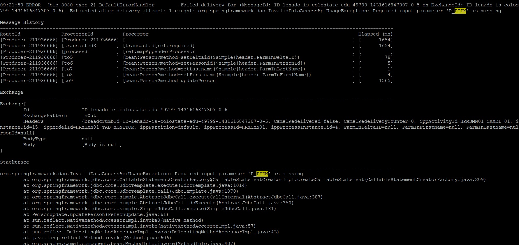

Issue got half resolved. New insights however also new questions - the activity did abort according to LOG ?!! Smile -- see log snippet below.
However, an exception was thrown after activity was set to 'Aborting'. Here, it appears a rollback of a JTA transaction failed which caused the process itself to not start up properly.

in carnot.log found
--- log snippet
13:14:15 WARN - [bio-8080-exec-4] TransactionErrorHandler - Transaction rollback (0x521f299b) redelivered(unknown) for (MessageId: ID-lenado-is-colostate-edu-45147-1431630695144-0-5 on ExchangeId: ID-lenado-is-colostate-edu-45147-1431630695144-0-6) caught: org.springframework.dao.InvalidDataAccessApiUsageException: Required input parameter 'P_PIDM' is missing
13:14:15 INFO - [bio-8080-exec-4] DebugInterceptor - --> isolate
13:14:15 INFO - [bio-8080-exec-4] Security - Partition: default, Domain: default.
13:14:15 INFO - [bio-8080-exec-4] DebugInterceptor - <-- isolate
13:14:15 INFO - [bio-8080-exec-4] AuditTrailLogger - Processing event Event: [objectOID = 15, type = 1, handlerOID = -1, handlerModelElementOID = 30064772470] for handler Event Handler: (User: motu (Realm: carnot) (Of the Universe, Master))
13:14:15 INFO - [bio-8080-exec-4] ActivityInstanceBean - State change for Activity instance 'HRMSMN01_CAMEL_01', oid: 15 (process instance = 4) (model oid = 7, version = 1, revision = 0): Created-->Aborting.
13:14:15 INFO - [bio-8080-exec-4] DebugInterceptor - <-- startProcess
13:14:15 ERROR- [bio-8080-exec-4] ExceptionHandler -
org.springframework.transaction.UnexpectedRollbackException: JTA transaction unexpectedly rolled back (maybe due to a timeout); nested exception is javax.transaction.RollbackException: Unable to commit: transaction marked for rollback
at org.springframework.transaction.jta.JtaTransactionManager.doCommit(JtaTransactionManager.java:1014)
at org.springframework.transaction.support.AbstractPlatformTransactionManager.processCommit(AbstractPlatformTransactionManager.java:755)
at org.springframework.transaction.support.AbstractPlatformTransactionManager.commit(AbstractPlatformTransactionManager.java:724)
at org.springframework.transaction.support.TransactionTemplate.execute(TransactionTemplate.java:148)
at org.eclipse.stardust.engine.api.spring.SpringTxInterceptor.invoke(SpringTxInterceptor.java:56)
at org.eclipse.stardust.engine.core.runtime.interceptor.MethodInvocationImpl.proceed(MethodInvocationImpl.java:130)
at org.eclipse.stardust.engine.core.runtime.interceptor.MethodInvocationImpl.execute(MethodInvocationImpl.java:68)
at org.eclipse.stardust.engine.core.runtime.beans.InvocationManager.invoke(InvocationManager.java:53)
at com.sun.proxy.$Proxy63.startProcess(Unknown Source)

you need to add onException element in your route and mark the thrown exception as handled:
<onException>
<exception>...InvalidDataAccessApiUsageException</exception>
<handled>
<constant>true</constant>
</handled>
</onException>
this will prevent the transaction to be roll ed back at Camel route level.
The exception will be propagated to Stardust and you will be able to handle it using
for more details please refer to the example at https://wiki.eclipse.org/Stardust/Knowledge_Base/Integration/Camel/Exception_Handling_in_Generic_Camel_Application
Best Regards
